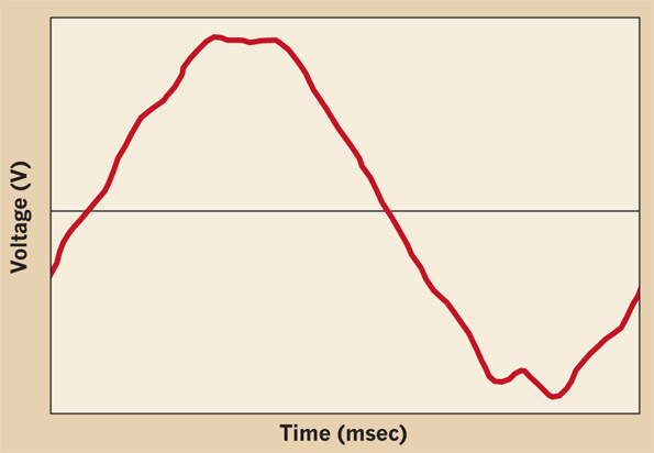

    Voltage waveform with about 12% harmonic distortion.
    The Figure illustrates an example of a voltage sine wave with a significant amount of harmonic distortion captured at the main utility feeder to a commercial facility. Notice that a lot of the distortion occurs at the maxima and minima of the waveform. This voltage waveform has about 12% distortion. Some of the pieces of electronic equipment in this facility that use electronic power supplies experienced power supply failures caused by this distortion.
