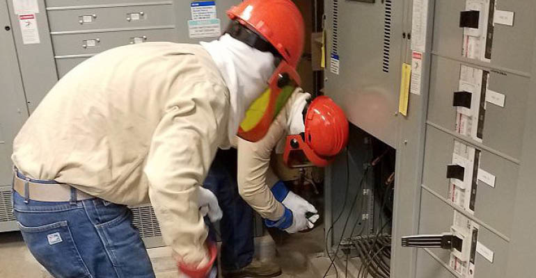

However, power quality analysis results are only as effective as the data collected for the analysis. A well thought out and planned effort is critical prior to investing time and money into the process. For troubleshooting discrete equipment issues, a plan may be as simple as determining where the incoming power connections can be easily accessed, what level of personal protective equipment (PPE) is needed to create an electrically safe work condition for metering connections, what parameters are needed to be monitored, and how long the device should be monitored for data collection.
Executing a permanently installed power monitoring capability to improve long-term system reliability requires more detailed planning to maximize effectiveness with available resources. An E3MP includes a criticality analysis on the systems and associated electrical assets. This criticality analysis, when properly performed, provides an objective list of all the electrical assets and how important they are to the facility operational mission priorities. This allows the opportunity to direct the appropriate resources toward the most critical equipment, which should, in turn, have a positive impact on the overall reliability of the system. For the most critical electrical assets, the appropriate level of condition-based maintenance may include permanently installed online power quality monitoring.
Another location to consider for permanent monitoring capabilities is as close as practical to the point of service. This will provide a baseline of the quality of the power that is coming in to the system from the electric utility provider. However, planning for this connection needs to include a risk analysis due to the high potential for large fault currents and high arc flash incident energy levels. Once installed at the point of service, this singular location can be quite useful in determining the location of power disturbances. If the facility can tolerate momentary power interruptions, individual circuits can be isolated to detect which circuit has the disturbance on it. Then, the same isolating process can continue through the distribution system of that circuit until the device causing the disturbance is identified. Obviously, more monitoring devices installed on the system will minimize the level of interruption needed during troubleshooting by allowing detection of the disturbance closer to the cause.
