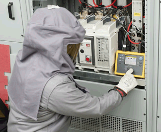

Photo. To measure the effects of the harmonics generated
by the VFD or UPS, set up your logger/analyzer at the
point of common coupling (PCC).

Once you've installed any harmonic filters and the systems are operating, you should monitor and record harmonic distortion created by the VFD or UPS (see Photo). Because the recommendations noted in IEEE 519, “Recommended Practices and Requirements For Harmonic Control In Electrical Power Systems,” are based on the point of common coupling (PCC), you should set up and monitor at this point in the system. Typically, this PCC is the point where the VFD or UPS load feeder leaves a bus energized by a power source.

In all cases, you should observe a decrease in the magnitude of harmonics as the harmonic order increases. However, be especially aware of any abnormal magnitudes at any harmonic frequency as observed on the harmonic graph. This could be an indication of the VFD or UPS harmonics creating a resonance situation with power factor correction capacitors in the system. You must take corrective action here to avert this dangerous situation.
After viewing the harmonic graph for expected harmonic frequencies and making sure no abnormalities exist, you should view the THD for voltage. This should not be more than 5% (Fig. 4).
Fig. 4. Screen shot of analyzer showing harmonic
current content and THD levels.
If the measured THD is greater than this, you should determine the best solution to bring THD within acceptable limits. Possible solutions could involve harmonic filters, isolation transformers, or moving loads to other feeders or branch circuits.
