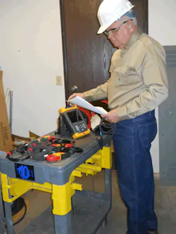

Follow manufacturer’s instructions for connecting and setting up the analyzer. Because of the amount of test equipment and supporting documentation that is needed, it is often best to have an equipment cart dedicated for power quality work. In addition to technical expertise, the underlying key to a successful survey is planning and organization. Three common mistakes when connecting power quality analyzers are:
  1. Failure to observe current polarity. Make sure the arrow on current clamps points toward the load. If the arrow points in the wrong direction, a negative current value is obtained on the analyzer for that phase.
  2. Not matching current/voltage probes. If analyzer input phase “A” is clipped onto phase “B,” it is obvious readings will be erroneous. Color code individual leads such that voltage and current leads for each phase are the same color, and connect carefully to prevent such errors.
  3. Relying on battery power to complete a lengthy monitoring session. While fully charged analyzer batteries are meant to last hours, nothing is more frustrating than to find key power quality events were not recorded because the analyzer shut down. Be sure to keep the analyzer plugged into an AC source for recording parameters when you will be away from the equipment.
