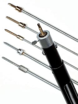

Developed specifically for electricians, the LagMaster-Plus allows users to hang ceiling wire, jack chain, purlin clips, threaded rod, and smooth rod from the ground. Powered by any ⅜-inch or ½-inch battery-operated or corded drill, the tool also can be used for overhead screw installation. In addition, its thin profile allows access to tight spaces.

What makes the LagMaster-Plus most unique, Dockery says, are the plug-in heads that are specific to each application.
“For example, the wire plug-in head hangs 12- or 9-gauge wire, while the socket plug-in heads work with ⅜-inch or ¼-inch threaded rod up to 10 feet long,” he explains.
Additional product features include a ¼-inch hex head that transforms the pole into a long screwdriver, a twist-out element that prevents over-torquing and strip out, and a head that works with Ramset's Viper powder-actuated tool.
