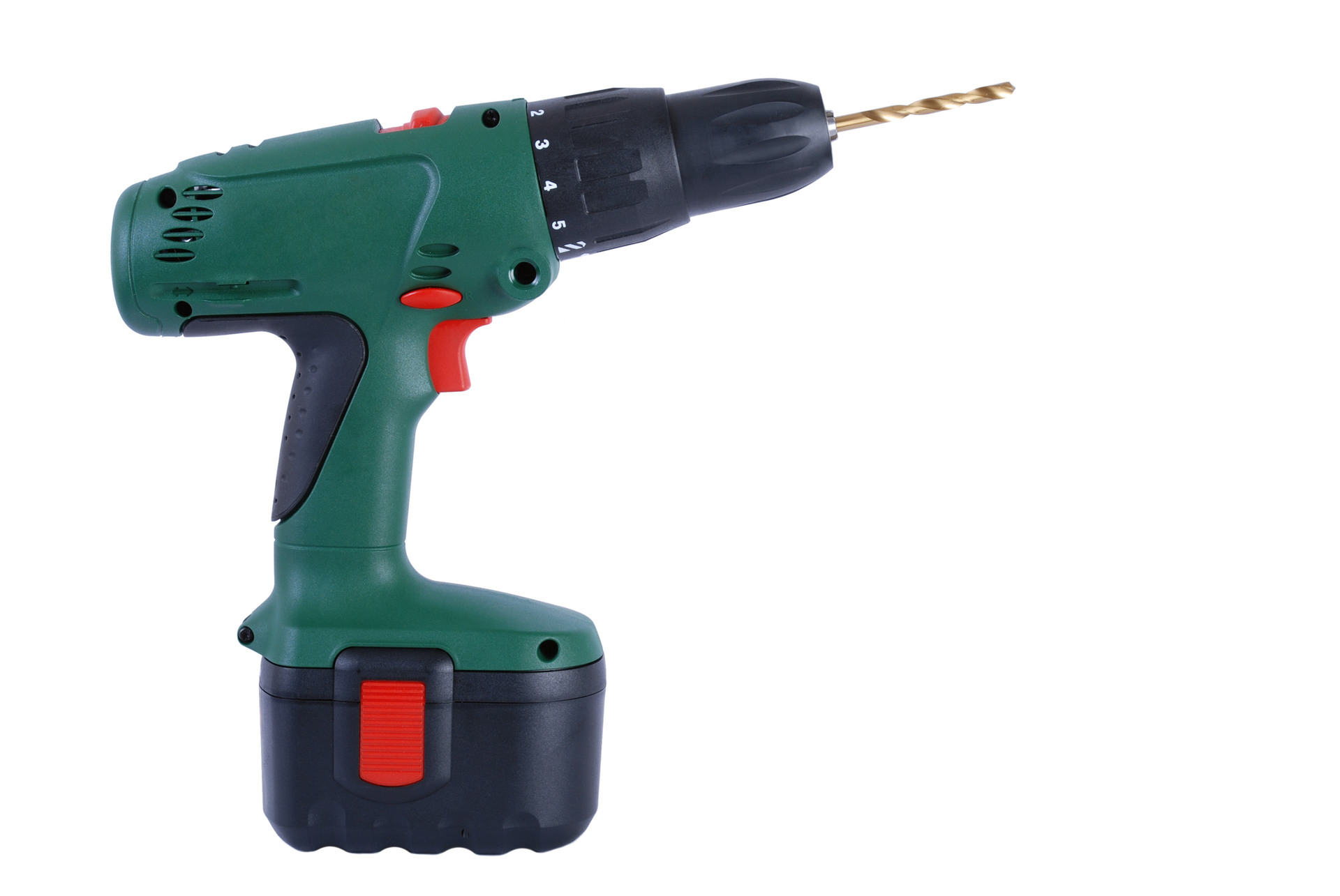

Battery-powered tools reduce cord management dramatically, but still present other safety issues.
Battery-powered tools have had a strongly positive effect on productivity in the field. And they confer a safety advantage by eliminating tripping hazards (and, to an extent, shock hazards) from misuse of portable cords.
However, the safety advantages can be moot if the use of these tools leads to a “no dangers to even think of” mindset. Other dangers do exist. Consider these categories:
Batteries
  • Industrial-grade, battery-powered tools use lithium batteries. Don’t leave them out in the sun.
  • If you drop a battery while changing batteries (or drop the tool with the battery attached), stop to give it a careful visual inspection. If the case is cracked or damaged in any way, take that battery out of service.
  • Don’t overcharge the batteries. While most charging systems have some form of overcharge protection, you still want to remove batteries once they are charged. Just as you don’t toss a hairdryer into an occupied bathtub and rely on the GFCI to protect the occupant, don’t rely on automatic protection to cover for sloppy charging practices.
  • Don’t run a battery charger near sources of flammable vapors.
  • When running the portable cord to a battery charger on a job site, follow the recommended safety procedures for portable cords (i.e., run each cord in a way that doesn’t create a tripping hazard).
