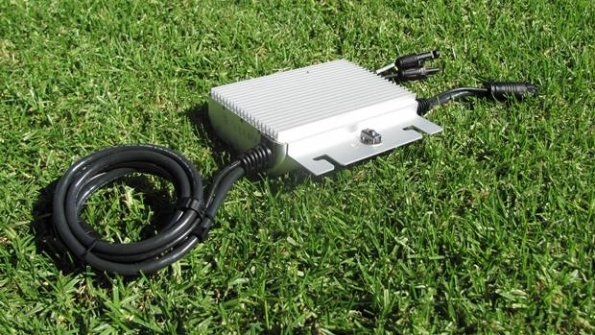

The added functionality is the result of upgraded solar inverters, which link distributed generators to the grid
In a few months, rooftop solar power systems in California are going to start regulating voltage levels and perform other grid-support jobs.
According to the IEEE Spectrum, the added functionality is the result of upgraded solar inverters, which link distributed generators to the grid. The devices can mitigate both excessive voltage and voltage drops caused by fluctuating solar generation, thus preventing potential power quality problems.
