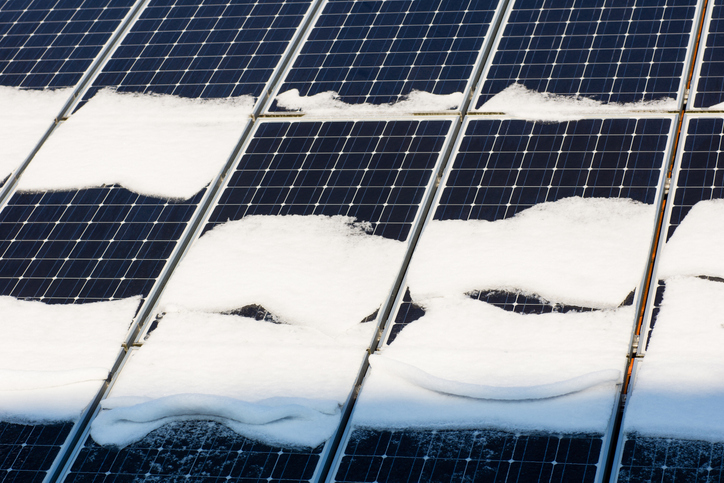

The uses proposed for the snow-TENG device are diverse and interesting, mostly wearable devices for tracking athletes and remote power applications. Researchers see a natural application in pairing the snow-TENG with solar panels to generate power when snowfall lowers the output of photovoltaics.
