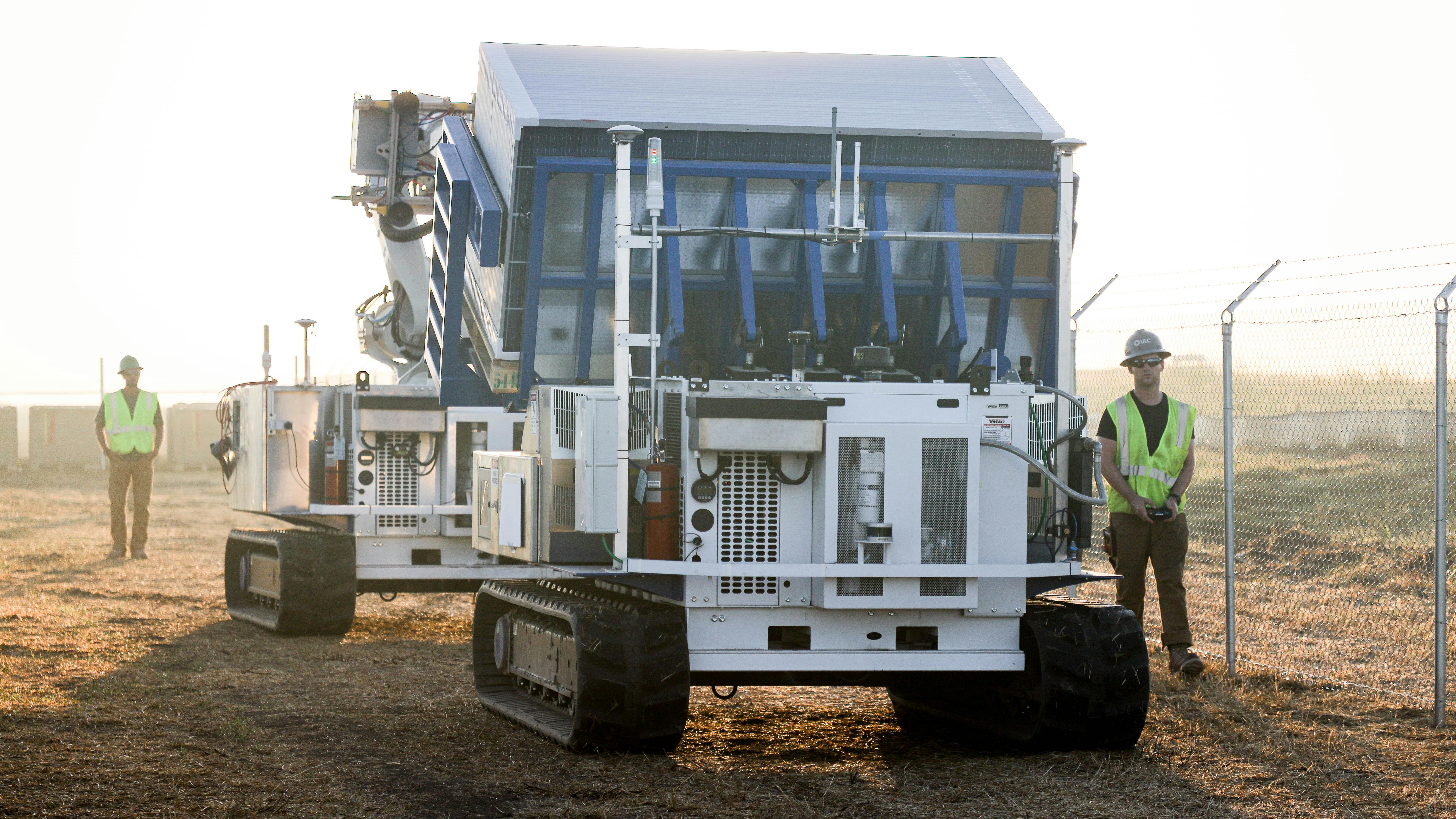

The robots were developed by Rosendin in a partnership with ULC Technologies, LLC, a developer of innovative robotic solutions within the energy industry. The working prototype was built to withstand environmental elements including extreme temperatures, wind and rain, puddles and mud, and uneven and steep rocky terrain up to 30-degree incline.
The hybrid gas and battery-powered system includes a Panel Setting Robot featuring a tracked, construction-grade robotic platform with an integrated robotic arm and 9-vacuum suction cups to lift and place PV panels precisely. Two Panel Carrying Robots work in tandem to transfer pallets of PV panels between the loading area and the installation point, eliminating downtime with a consistent supply.
Lincoln first came up with the idea in 2019 as a solution to reduce physical strain on electrical workers. The collaborative robots, or cobots, feature built-in safety measures and offer both autonomous and manual operation via handheld controllers. These machines effortlessly handle PV panels weighing 100 lbs., while skilled electricians focus on critical grid connections to maximize efficiency and worker safety.
