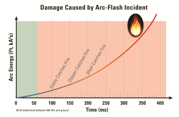

    The damage caused by an arc flash increases rapidly with time

    As the flash developed, the relay responded by sending a trip signal to the main breaker in less than 1 msec. The breaker then mechanically cleared the fault with a total clearing time of 51 msec. Without the arc-flash relay, the breaker would have relied on over-current relays, for which a typical ‘trip signal’ time is 16 msec to 32 msec. As a result of the shortened reaction time, damage was minimized. A thumb-size piece of copper was burnt off one of the bus bars and the cabinet and the switchgear inside it suffered only minor damage.
