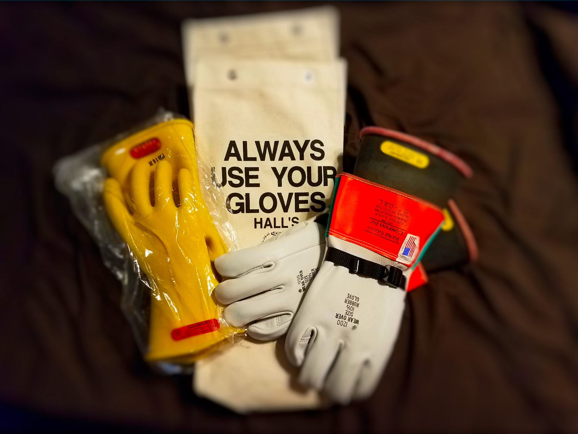

Do I need to wear voltage-rated gloves when testing low voltages with a handheld meter?
The context of this question is typically related to 120VAC nominal circuits.
The NFPA 70E defines “Working On (energized electrical conductors or circuit parts)” as: "Intentionally coming in contact with energized conductors or circuit parts with the hands, feet, or other body parts, with tools, probes, or with test equipment, regardless of the personal protective equipment (PPE) a person is wearing."
NFPA 70E Sec. 130.4(F)(1) states that any part of a qualified person’s body that crosses into the Restricted Approach Boundary (RAB) shall be insulated.
The NFPA 70E Handbook has the following clarification after the Restricted Approach Boundary section: "This section recognizes that a tool or other object is considered to be an extension of the person’s body. If a person is holding an object, the requirements of this section apply to both the person and the object."
The handbook is clearly identifying objects being held by the worker as an extension of their person regardless of whether or not they are insulated. Therefore, holding test probes that are in contact with the energized or potentially energized conductors is equivalent to contacting those energized conductors with your hands. So, what is the proper method for protecting our hands from this hazard?
As per NFPA 70E Sec. 130.7(C)(7)(a), "Employees shall wear rubber insulating gloves with leather protectors where there is a danger of hand injury from electric shock due to contact with energized electrical conductors or circuit parts."
Therefore, if the qualified person’s hands, tools, probes, or test equipment cross into the RAB of systems rated 50V or greater (AC or DC), then the use of voltage-rated gloves is required. This includes using a handheld meter to check voltages on 120VAC circuits. So the answer to the subject question is YES. Voltage-rated gloves and leather protectors are required when testing any voltages greater than 50V because testing is touching.
