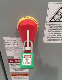

An equipment/department lock secures an electrical panel.
(Photo courtesy of Design Safety Engineering, Inc.)

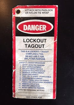

Procedures and a sign-off for notification of affected personnel adorn a LOTO notice.(Photo courtesy of Design Safety Engineering, Inc.)

The electrical panel lock above includes a hazardous voltage warning.

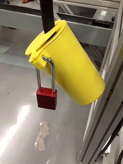

An electrical plug fitted with a lockout/tagout (LOTO) cover.

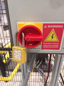

A control panel is locked out and tagged with a warning that removal is restricted to a named individual (photo courtesy of Design Safety Engineering, Inc.).

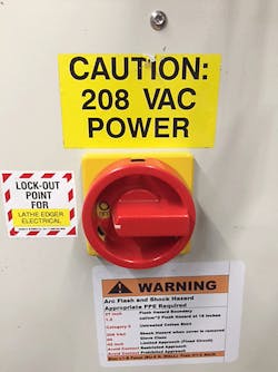

A lockout point on a control panel carries an arc flash and shock hazard warning.

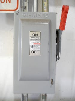

This image shows an electrical disconnect on a heavy-duty safety switch capable of being locked out (photo courtesy of Design Safety Engineering, Inc.).
