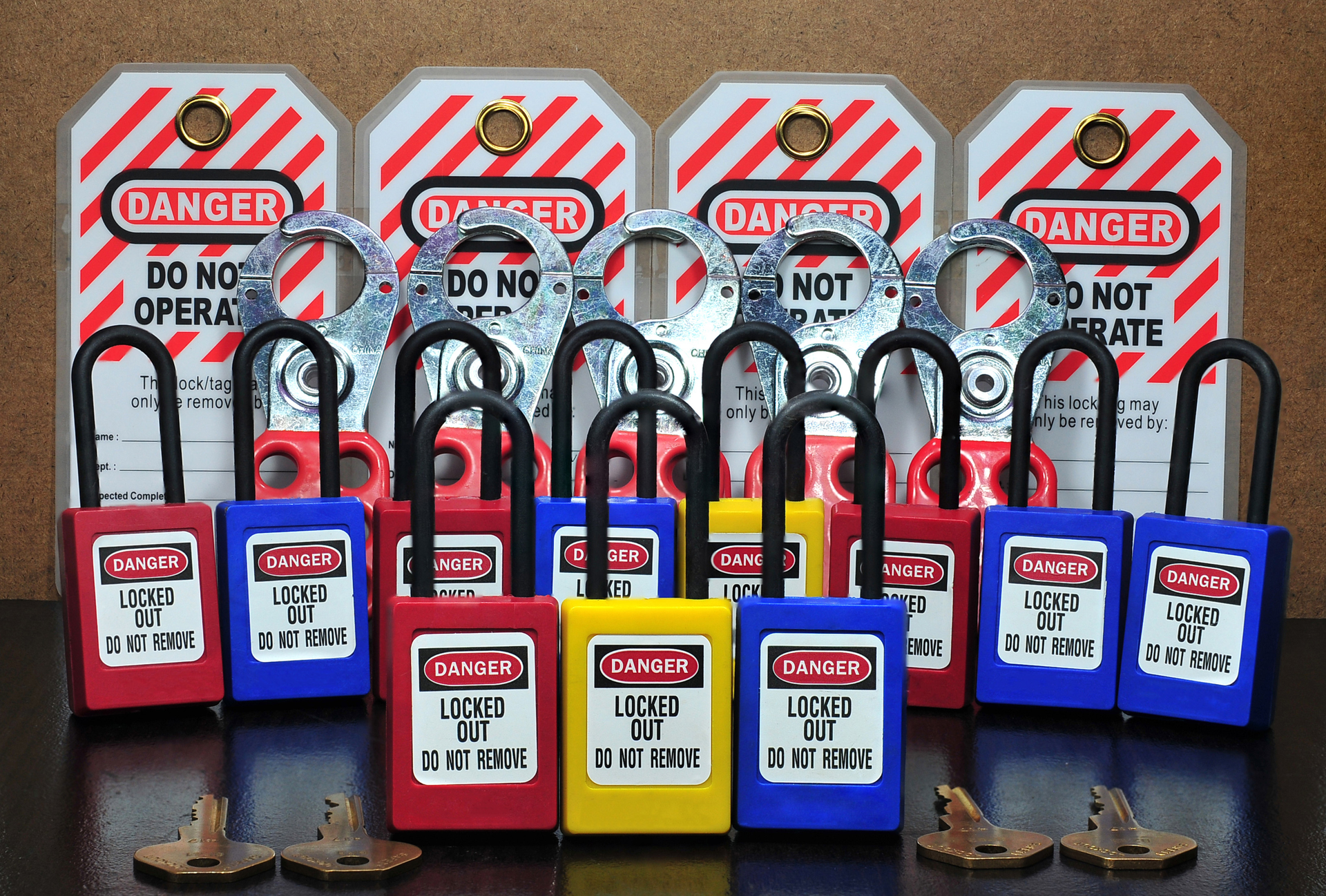

Why make someone open a panel, lock out a breaker (if it’s even lockable), and hang a tag in that crowded space? It is worse when three other crews have lockout/tagout going on in that panel. Where practical, create a lockout/tagout point with a disconnecting switch.
Use the same strategy where crowding of any sort can complicate lockout/tagout. Remember, it is a system not only of energy isolation, but also of communication. You need room for tags, not just locks. In some cases, multiple crews or departments will need simultaneous access to de-energized equipment. For lockout/tagout, that means hanging a hasp onto which individual locks then get hung.
If operations, a mechanic, two electricians, and three outside contractors need to hang their locks, do you really have room for seven locks and tags and possibly two hasps in that enclosure?
