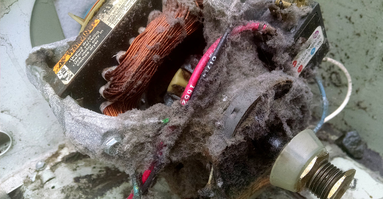

There I was driving along a side road when I saw this hunk of scrap metal out at the curb. We all know that these days free metal, especially when organized, is a good way to pick up some extra cash. So I stopped and tossed this well-used electric dryer into the back of my pick-up and continued on my way home.
I decided to dissect it, grab some copper and aluminum from it, and before long parts were scattered all over my garage floor. It was then that I saw why it had been discarded in the first place — and why I decided to share what I found with my fellow electricians, firefighters, and investigators.

Once I removed the sheet metal panels from the rear compartment, I discovered a large buildup of lint, some burned up conductors, and a twist-on wire connector holding them together.
Now the picture is starting to become clearer. At some point, a connection in the dryer undoubtedly failed. Someone, who obviously “fixed” the problem by making that splice, became the hero when the dryer came back on again! However, what he or she didn’t think about was the connector — although rated for 105°C (depending on manufacturer) — could exceed its rated temperature. In this case, it did, which caused the plastic to melt. In turn, the connection failed and ignited the lint surrounding the splice. Add to that the fact that the UL listing of the machine has been violated, and someone is definitely to blame here.
If an investigator had discovered this, fingers would start to be pointed at who fixed the dryer. Was it a handyman, homeowner, previous homeowner, or was it you (the electrician) helping your customer? If the fire that undoubtedly ensued was contained to room and contents, you might have gotten lucky. However, if injuries or deaths occurred, that’s a whole different story.
