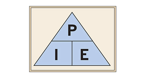

The watts calculation is very simple. It’s just voltage times current, or E x I. But how is this useful?
Many loads today are specified in watts. These include not just lamps or luminaires, but also motors. Let’s look at a lighting example.

You look at the drawings and see that there now are 12 lamps on each branch circuit. You see the breakers are all 20A. A dozen 400W lamps is a total load of 4,800W. This is a 277V system. Dividing watts by volts, you see the total load is just over 17A.
But lighting is a continuous load. That means the breakers should be loaded to no more than 80% to comply with the NEC. The maximum load is 16A, not the 17A that now exists. There are too many lamps on each circuit; someone didn’t do their watts calculations or didn’t multiply the continuous load by 125%.
How many LED replacements can you put on the same 20A circuit while keeping the load to no greater than 80% of breaker rating? First, multiply 277V by 16A. That gives you the maximum watts, which is 4,432W. Now divide that number by 150, and you arrive at 29 plus some digits. You can install 29 LED units on each circuit; this assumes the wattage rating includes the power supply, also.
