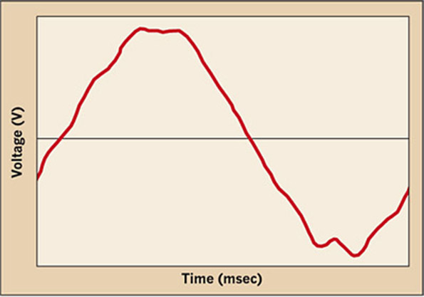

Voltage waveform with about 12% harmonic distortion.
• Excess harmonics. A harmonics tester is a good investment. If you have excess harmonics, it means the equipment has to use more power to do the same work. One sign you may have excess harmonics is that thermograhic surveys show conductors to be hotter than they should be. That heat is wasted energy.
