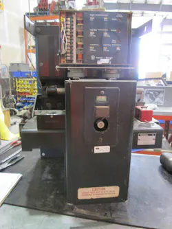

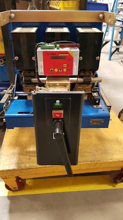

A recent assessment by the CSA Z463 Technical Committee deemed the rackable LVACB a device that carries a higher risk than most other devices in an electrical power system. This device is quite often operated by maintenance staff to establish an electrically safe work condition. LVACBs have an onboard protection system, including a series trip unit or an electronic trip unit consisting of current transformers, a wiring harness, and a protective relay as well as some type of mechanical actuator to open the device.
When not exercised regularly, an LVACB can become inoperable, without any prior warning or indication to the operator. Combining the features of rackable, frequently operated, and on-board complete protection systems makes the likelihood and impact of failure one of the highest exposure points in the electrical power system (Photos 1a and 1b).

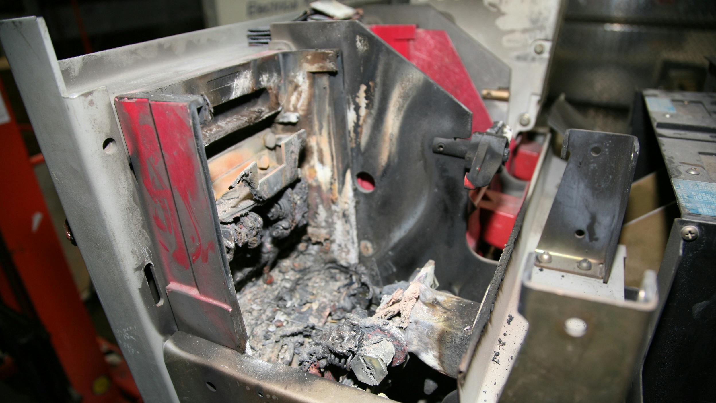

  • Mechanical operation is always an issue, often due to improper lubrication, lack of exercise, wear on the main operating mechanism, or even overlubricating — particularly when applied to the finger clusters instead of the stabs, which may be energized or not accessible (Photo 2). It is extremely important to understand the consequences of lubricating the clusters versus the stabs or using dissimilar lubrications, as this frequently causes contact or racking problems.

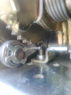

  • Sluggish initial operation for the first couple of operations can usually be avoided with regular maintenance of the operating mechanism and proper lubrication (Photo 3).
