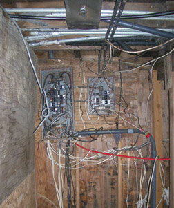

DISPOSAL DILEMMA
Chris Krueger, vice president and master electrician for Airways Electric, Inc. in Memphis, Tenn., found this while on a service call at a residential property. “One of our customer's friends called us and said she had a fire and would like for us to come check her electrical box. Bet you've never seen anything like this!”
This panelboard violates the simple rule requiring sufficient working space about equipment, which is covered in 110.26. The evidence of an installation by someone who was not concerned about the occupant's safety could have led to a loss of life. Once again, I'm disturbed at the work being done around the country by unqualified and irresponsible workers.
