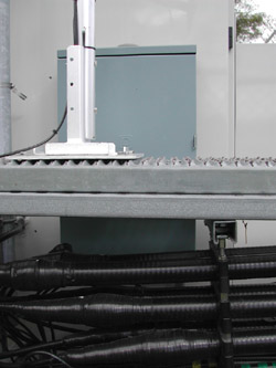

NO ROOM TO BREATHE
Dan Haley, president, RTB Contracting, Inc., Pacific, Wash., noticed this installation at a cellular communications site while working on an adjacent property. Notice that the load center is virtually covered by the coax ice bridge. Communications systems may have their own set of rules in the NEC, but that doesn't mean installers shouldn't abide by general installation rules as well.
Per 110.26 of the 2005 NEC, “Sufficient access and working space shall be provided and maintained about all electric equipment to permit ready and safe operation and maintenance of such equipment. Enclosures housing electrical apparatus that are controlled by a lock(s) shall be considered accessible to qualified persons.
“(A) Working Space. Working space for equipment operating at 600V, nominal, or less to ground and likely to require examination, adjustment, servicing, or maintenance while energized shall comply with the dimensions of 110.26(A)(1), (2), and (3) or as required or permitted elsewhere in this Code.
“(1) Depth of Working Space. The depth of the working space in the direction of live parts shall not be less than that specified in Table 110.26(A)(1) unless the requirements of 110.26(A)(1)(a), (b), or (c) are met. Distances shall be measured from the exposed live parts or from the enclosure or opening if the live parts are enclosed.”
