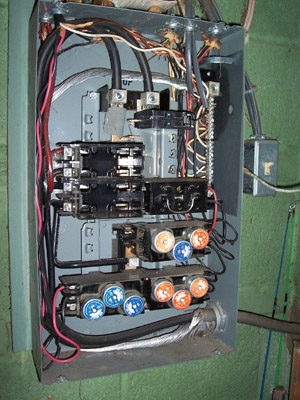

FUSE-TO-CIRCUIT-BREAKER CONVERSION
Timothy Clark, owner, TEC Electric, Dumfries, Va., ran across this interesting installation, which the homeowner told him was completed by a contractor. In his e-mail to EC&M, Clark pointed out the 15A piggyback installed above the main fuses.
This type of do-it-yourself work isn't uncommon and violates the requirements of 90.7, which in part states, “It is the intent of this Code that factory-installed internal wiring or the construction of equipment need not be inspected at the time of installation of the equipment, except to detect alterations or damage, if the equipment has been listed by a qualified electrical testing laboratory that's recognized as having the facilities described in the preceding paragraph and that requires suitability for installation in accordance with this Code.
“FPN No. 1: See requirements in 110.3.
“FPN No. 2: ‘Listed’ is defined in Article 100.
“FPN No. 3: Annex A contains an informative list of product safety standards for electrical equipment.”
