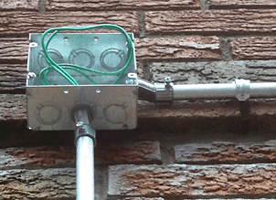

Permit-Free Zone
The electrical work at this scooter and bicycle shop was done by the owner of the property. The open junction box and all of this equipment is not designed to be used in a wet location and violates the rules listed in 110.11.
"Unless identified for use in the operating environment, no conductors or equipment shall be located in damp or wet locations; where exposed to gases, fumes, vapors, liquids, or other agents that have a deteriorating effect on the conductors or equipment; or where exposed to excessive temperatures.
"Informational Note No. 1: See 300.6 for protection against corrosion.
"Informational Note No. 2: Some cleaning and lubricating compounds can cause severe deterioration of many plastic materials used for insulating and structural applications in equipment.
"Equipment not identified for outdoor use and equipment identified only for indoor use, such as ‘dry locations,’ ‘indoor use only,’ ‘damp locations,’ or enclosure Types 1, 2, 5, 12, 12K, and/or 13, shall be protected against damage from the weather during construction.
"Informational Note No. 3: See Table 110.28 for appropriate enclosure-type designations."
The NEC defines a wet location as: an installation placed underground or in a concrete slab or masonry in direct contact with the earth; a location subject to saturation with water or other liquids, such as a vehicle washing area; or an unprotected location exposed to weather.
