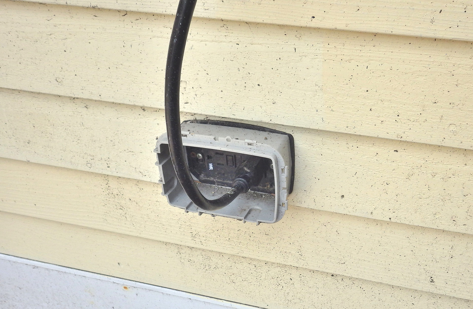

What’s Wrong Here? Hint: Less Than Extra-Duty Rated!
Hint: Less than extra-duty rated
 This installer did a great job of choosing the correct type of receptacle. It’s a weather resistant (WR), GFCI-type receptacle as required by Sec. 406.9(B)(1). Unfortunately, the installer did not do a great job of selecting the correct cover. That is probably why part of the cover is missing. Section 406.9(B)(1) requires outlet box hoods to be identified a “extra-duty” rated for this application. The installer also never bothered to remove the pry-outs or notches for the cord to pass through when the cover is installed and tightly closed. Now this receptacle is directly exposed to rain, snow, and all the other damaging elements that mother nature can throw at it. For a few extra dollars and a couple more minutes of his time, this installer could have had an installation that was completely Code-compliant. Instead, he ended up a with an installation a little less than Code-compliant, and a lot more likely to have an equipment failure from water or moisture damage.
