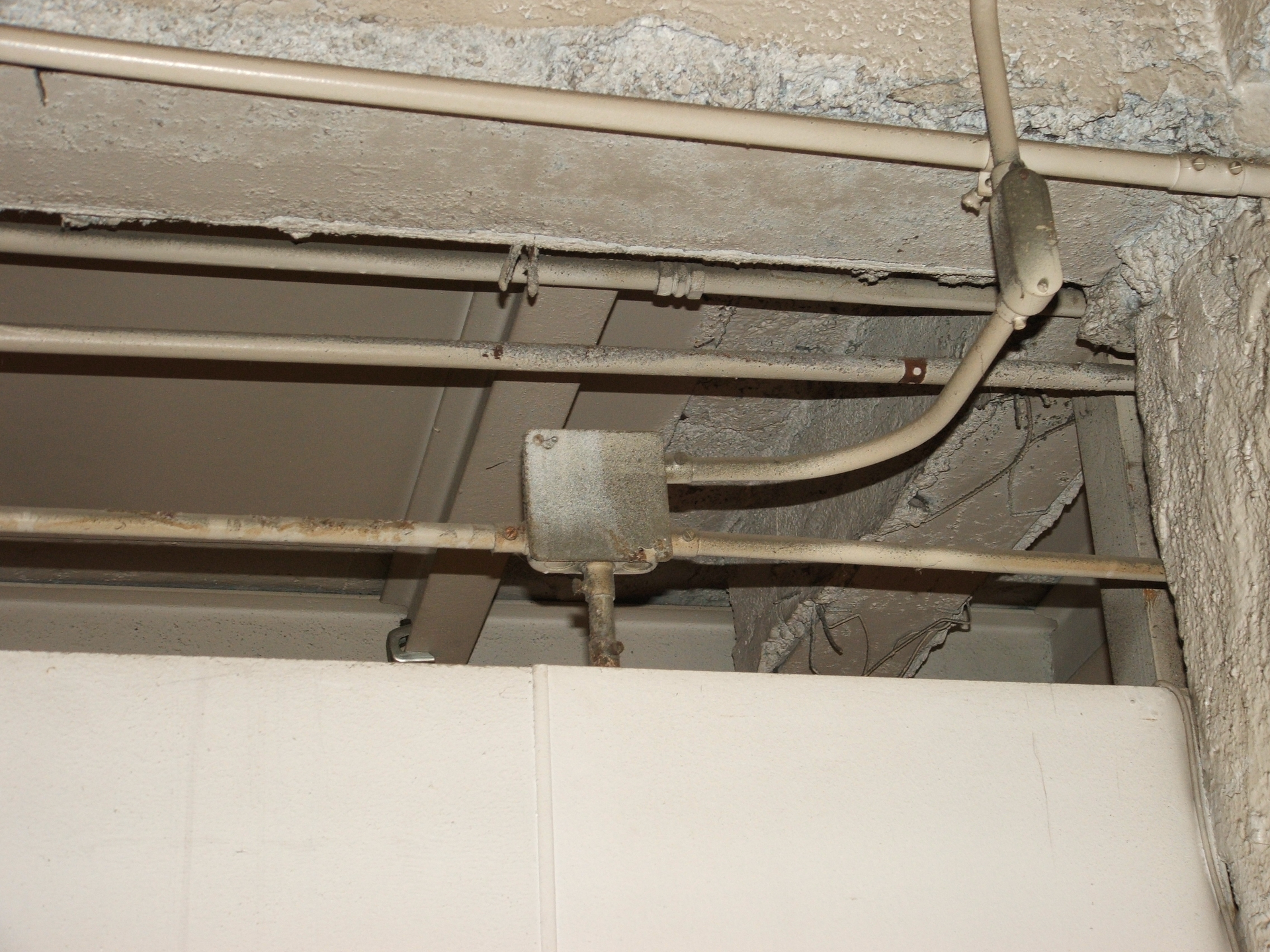

What’s Wrong Here? Hint: A Lousy Support System
Hint:  a lousy support system
No matter how may EMT raceways are connected to this box ― in this case four ― the box will never be considered properly supported. Section 358.12(2) clearly states that EMT is not permitted to be used for supporting luminaires or any equipment other than conduit bodies no larger than the trade size of the EMT. The conduit body on the right side of this photo is not a problem. However, the 4-in. square box in the middle of the photo has no supports other than the EMT raceways. This is a violation. Sections 314.23(A) through (H) provide many other Code-compliant options for properly supporting boxes. Some of those options include surface mounting, structural mounting, using nails and screws, braces, framing members, support wires, and using RMC or IMC raceways that are threaded into the enclosures. None of the options include using EMT for the support of boxes. Perhaps installing an anchor or beam clamp, and then using threaded rod to support this box would be a simple solution.
