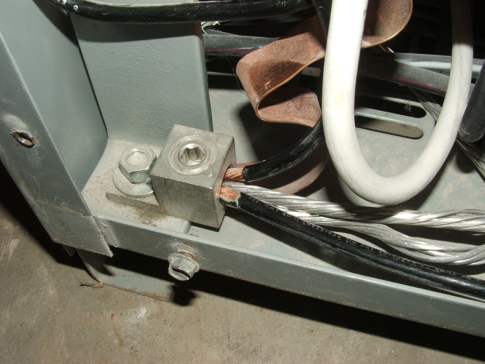

How well do you know the Code? Think you can spot violations the original installer either ignored or couldn’t identify? Here's your chance to moonlight as an electrical inspector and second-guess someone else's work from the safety of your living room or office. Can you identify the specific Code violation(s) in this photo? Note: Submitted comments must include specific references from the 2020 NEC.

I think the most obvious problem is the fact that the circuit breakers are installed in a position where the ON position of the handle is in the “down” position, contrary to the requirements of Sec. 240.81. Vertically operated circuit breakers must be installed so the “up” position of the handle puts the circuit breaker into the ON position. Upside-down circuit breakers could pose a real safety hazard if a worker mistakenly flips the breaker “down” thinking that he or she is turning the power off when the person is actually turning the power on. Another problem is the lack of labeling of each circuit breaker to indicate what it serves. Section 408.4(A) requires that every circuit be legibly marked to indicate its specific purpose or use. Similarly, Sec. 110.22(A) requires each disconnecting means to be legibly marked to indicate its purpose. Your guess is as good as mine as to what these breakers serve.
