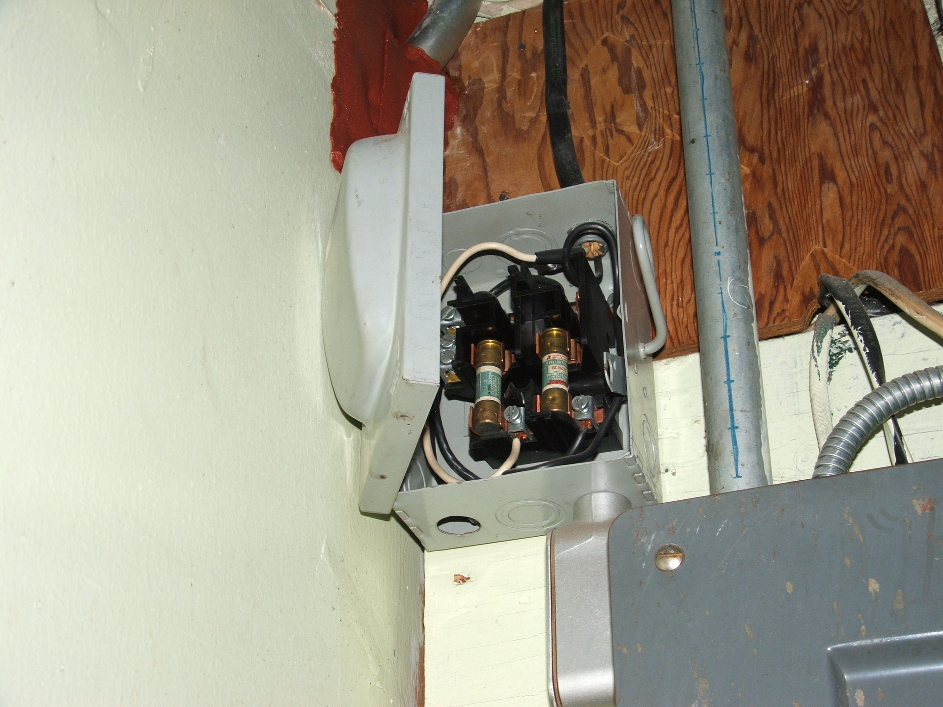

What’s Wrong Here? Hint: Not Quite 90
Test your NEC knowledge with this shoddy installation.
How well do you know the Code? Think you can spot violations the original installer either ignored or couldn’t identify? Here's your chance to moonlight as an electrical inspector and second-guess someone else's work from the safety of your living room or office. Can you identify the specific Code violation(s) in this photo? Note: Submitted comments must include specific references from the 2020 NEC.
Hint: Not quite 90
Tell Them What They've Won…
Using the 2020 NEC, correctly identify the Code violation(s) in this month's photo — in 200 words or less — and you could win an Arlington Industries SL1B18 SLIDER BAR kit, which includes a stainless steel trap door cover and a 20A decorator-style, tamper-resistant receptacle. E-mail your response, including your name and mailing address, to [email protected], and Russ will select three winners (excluding manufacturers and prior winners) at random from the correct submissions. Note that submissions without an address will not be eligible to win.
June Winners
Our three winners this month were: Matt White, an electrical estimator for TDX Power Services of New Centerville, Idaho; Geoffrey Coetzee with Disher Electric, Stevens Point, Wis.; and John Freisen, a master electrician from El Paso, Texas. Each of them was able to correctly identify some of the Code violations in this photo.
The use of set-screw-type EMT connectors in this wet location was certainly one problem. Section 314.15 requires boxes and fittings installed in wet locations to be listed for use in wet locations. These connectors are not listed for wet location use. Using the EMT raceway to support this luminaire is a blatant violation of Sec. 358.12(2). I assume the typically short leads for this luminaire are spliced to the branch circuit wires inside the raceway. If so, this is a violation of Sec. 300.13. Also, the EMT is not supported and secured in compliance with Sec. 358.30.
