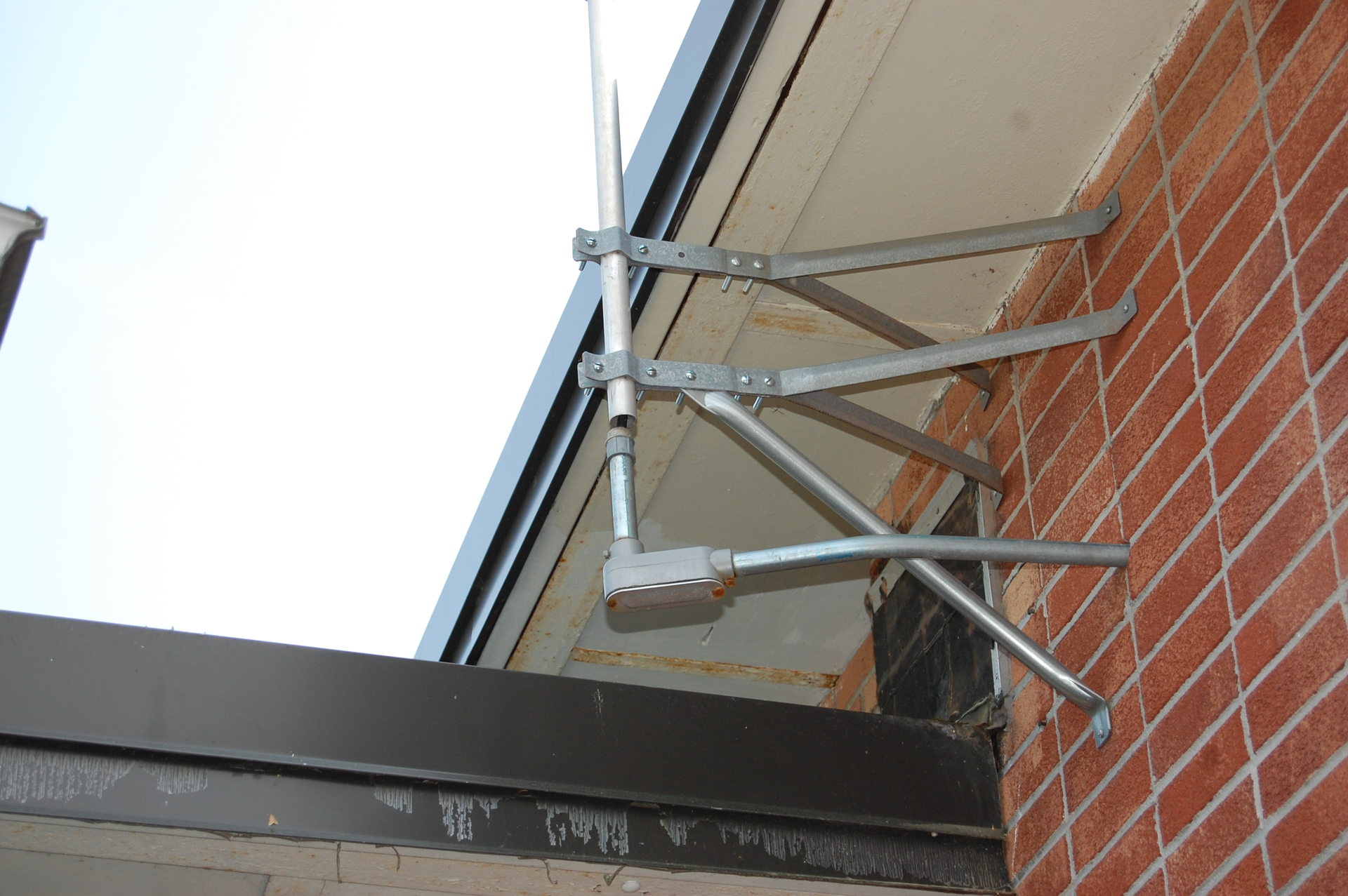

What’s Wrong Here? Hint: Give Me a Break!
Hint: Give me a break!
This installer used the wrong fittings for this exterior installation. The set-screw conduit body is not designed to be used in wet locations. For wet locations, Sec. 314.15 requires boxes, conduit bodies, outlet box hoods, and other fittings to be listed for use in wet locations. Water can easily enter this raceway where it’s separated and flow right through the electrical metallic tubing (EMT) and LB and into the building. In damp or wet locations, conduit bodies, boxes, and fittings must be either installed or equipped to prevent the entrance or accumulation of moisture.
Where the EMT is separated from the riser, I’m concerned about the lack of grounding and bonding for this metal equipment. Section 250.4(A)(2) requires conductive materials such as EMT raceways and other metal enclosures to be connected to earth to limit the voltage to ground on this equipment. These conductive materials must also be effectively bonded in accordance with Sec. 250.4(A)(3). These separated metal parts need to be connected to each other in order to be effectively bonded and grounded.
