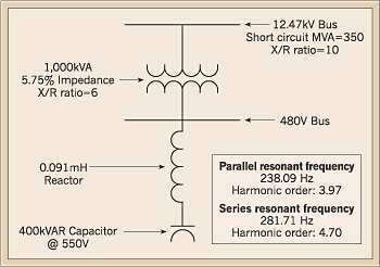

As a general statement, you can say that the parallel resonant point for a harmonic filter is about one harmonic order below the “tuned” or series resonant point of the filter and is therefore typically below any significant source of harmonics, assuming that the filter was designed properly for the system of interest. Fig. 1 depicts a sample system in which a filter could be installed. Fig. 2 shows the series and parallel resonant point for a 4.7th (5th) harmonic filter. Notice that the parallel resonant point is at the 3.97th harmonic for a 4.7th harmonic filter. Changing the source impedance components, such as transformer impedance or system impedance, on a distribution system will alter the results and detune the system.
This is why people are often concerned when they apply a “fixed” filter on a power system. The fear is that it will eventually become “detuned” with the system. However, this really isn't a big deal unless the utility changes configurations or the main service transformer is changed out, thus altering the system impedance.

Regarding the article “Power Factor Correction and Harmonic Resonance: A Volatile Mix,” is it correct that the parallel resonant point will always be below the series resonant point?
Carnovale's answer: Yes, the parallel resonant point is always below the series resonant point for a harmonic filter. The tricky part is when you have multiple-stage filters like 5th and 7th. Then you have multiple parallel resonant points. If you switch off the 5th filter and leave the 7th filter on, you'll likely hit parallel resonance near the 5th harmonic. For that reason, you should always turn on the lowest order filter first and turn off the highest order filter first.
