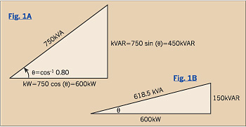

Power factor correction. Consider a 750kVA load operating at 80% lagging PF. Construct a power triangle to help determine the kW and kVAR components of the power ( Fig. 1A above).Solving for the real and reactive power values yields 600kW and 450kVAR, respectively. So of the 750kVA drawn from the source, only 600kW, or 80% of it, can do useful work. The reactive power, necessary to establish electromagnetic fields, adds a considerable burden to the source.
Last month's column showed that capacitors connected from line-to-neutral can furnish reactive power. With a 300kVAR shunt capacitor, the source has to provide only 150kVAR (450-300=150). Fig. 1B shows the resulting power triangle.
The kVA supplied by the source decreases to
and the PF angle θ decreases to
yielding a new power factor of cos 14°, or 97% lagging. This process of installing shunt capacitors to supply reactive power is called power factor correction.
