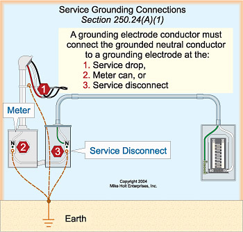

This brings up the question of how to comply with grounding electrode conductor requirements. Because a grounding electrode conductor must connect the grounded conductor to the grounding (earthing) electrode, the question of how expands to include where. Can you make this connection anywhere?
Location, location, location. Some inspectors require the grounding electrode conductor to terminate to the grounded conductor terminal at the meter enclosure. Other inspectors require the grounding electrode conductor to terminate to the grounded terminal at the service disconnect.
The Code says you can make this connection at any accessible location, from the load end of the service drop or service lateral up to and including the service disconnecting means [250.24(A)(1)] (Fig. 1). The choice then becomes an engineering decision that balances such factors as installation costs, available space, and maintenance issues.
