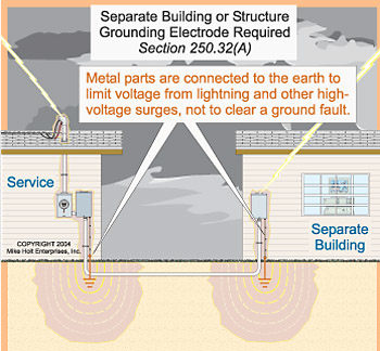

Disconnecting means. The purpose of grounding (earthing) the building or structure disconnecting means to the earth is to limit elevated voltages on the metal parts caused by lightning [250.4(A)(1)] (Fig. 1). Keep in mind that grounding doesn't:
  • Provide a low-impedance fault-current path to clear ground faults. In fact, the Code prohibits the use of the earth as an effective ground-fault current path since it's such a poor conductor of current [250.4(A)(5) and 250.45(B)(4)].
  • Protect electrical or electronic equipment from lightning voltage transients.
You don't need a grounding (earthing) electrode where only one branch circuit serves the building or structure [250.32(A)]. For the purposes of 250.32(A), you can consider a multiwire branch circuit to be a single branch circuit.
