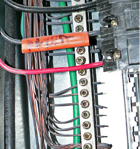

The corrosion includes the blackening of copper electrical wiring (Photo) and/or air-conditioning evaporator coils. “The first sign that most homeowners notice is that there’s a problem with the air conditioner,” says Allison Grant, Esq., a partner with Shapiro, Blasi, Wasserman & Gora, P.A., Boca Raton, Fla.
Grant began specializing in Chinese drywall cases after she discovered a condominium she owns was built with the offending gypsum. Currently, she represents close to 700 homeowners. “The air conditioner starts leaking Freon, so the tech comes out and keeps pumping it full of Freon, and then you need to replace the coils,” continues Grant.

The issue of repair or replace may be decided by more than expense, according to David Wojcieszak, P.E., LEED AP, and principal at Wojcieszak & Associates, Inc., Stuart, Fla. In the white paper “Repairing Electrical Installations Associated with Chinese Drywall,” to be used in conjunction with a field evaluation from a licensed professional with experience in electrical systems contaminated by the off-gassing of Chinese drywall or other indoor contaminants, Wojcieszak sets forth an additional protocol for drywall remediation, based on the NEC provisions for corroded systems, as well as state and local codes for his geographic location.
At minimum, the report recommends the insulated conductors can be cut back, the insulation stripped away, and the bare conductor reconnected. But this can be accomplished only if the newly exposed conductor has not been affected, and the remaining conductor length at receptacle and switch box locations meets the minimum 6-in. requirement dictated by NEC 300.14 for branch circuits. The conductor shall be replaced in its entirety if either condition is not met. The exposed ground conductor can be cleaned and reattached, but it must also meet the 6-in. requirement.
The report also outlines the protocol for working at the electrical load center. Remove all circuit breakers from the electrical panel. Evaluate the panel buss structure. If the buss is tin-plated copper, it normally can be cleaned and reused; however, a copper buss must be replaced. Evaluate the branch circuit and feeder conductors for corrosion, as described above, and repair or replace as required. Replace all copper ground bars or copper neutral bars as required, and install new circuit breakers.
Cleaning of the conductor ends is not recommended if sufficient good conductor length is available to clip off the formerly exposed end and reattach the newly exposed conductor. It is also not recommended to use any corrosion inhibitor on the new connections — you should clean the exposed lengths of uninsulated ground conductors with an approved lubricant cleaning agent.
Wojcieszak’s report separates light fixtures into two distinct categories: recessed and surface mount. Recessed fixtures have been found to be the least affected. The exposed, uninsulated ground wire located in the fixture junction box is a good indicator as to whether the fixture should be replaced. A black or corroded ground wire indicates a new fixture is required. A clean ground wire indicates the fixture may be reused if other current-carrying components are evaluated and determined to be safe. Surface-mount fixtures can be evaluated in a similar manner as recessed fixtures. At a minimum, exposed 2-conductor cords on any pendant-type fixture should be replaced.
