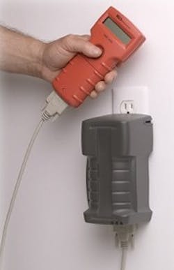

Circuit breaker analyzer The CBA-1000 circuit breaker analyzer is designed for testing branch circuit for compliance with 240.1 of the 2002 NEC. The unit plugs into any 120V receptacle, allowing electricians and technicians to conduct a controlled short circuit and analyze circuit protection device responses. The handheld instrument displays test results on a 2-line, backlit LCD and stores the collected

The CBA-1000 circuit breaker analyzer is designed for testing branch circuit for compliance with 240.1 of the 2002 NEC. The unit plugs into any 120V receptacle, allowing electricians and technicians to conduct a controlled short circuit and analyze circuit protection device responses. The handheld instrument displays test results on a 2-line, backlit LCD and stores the collected data for reporting. In addition to testing for maximum safe breaker response time and actual breaker response time, the unit will display line voltage and percent voltage drop.
