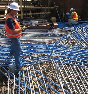

“The building’s footprint is fairly small — only 130 sq ft by 100 sq ft — yet the amount of conduit needed for the performance lighting and the video and sound was immense,” notes Pfaff. “One of the requirements was that none of the conduits or junction pull boxes could be exposed. So a big challenge was trying to find space for all that conduit.”
According to Pfaff, the extensive use of 3D drawings prior to installation along with a 3-layer “basket weave” of conduit within the 1-ft-thick floor slabs helped ensure everything fit. The theater’s distinctive seat towers, which allow for multiple seating configurations — proscenium, thrust, and flat floor — also tested McCarthy’s skills.
