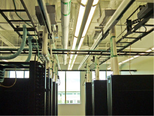

  1. Tray cable — A tray cable can be a thing of beauty, being that it is installed in ladder racks as an overhead distribution system, consisting of a ladder tray installed in a dedicated layer above the racks. Per NEC requirements in 392.11(A)(3), the cable must be installed in a single row across the bottom of the ladder tray and with appropriate spacing between cables.
The advantage of this system is that the power receptacles for each rack can be installed on the vertical face of the ladder tray, resulting in a branch circuit system that is completely visible and accessible, leaving the raised floor area void of any possible restrictions from the power cables.
The tray cable system also requires a data center space with high ceilings so that the power tray system can be on a separate plane from the data tray system. Although the initial installation is labor intensive and more expensive than other solutions, the result is an excellent solution for visibility. No longer is the system out of sight and out of mind.
  1. Flexible conduit installed in cable trays — Similar to the tray cable option, this approach consists of flexible conduits installed in a cable tray system above each row of racks. Each circuit out of the PDU is a separate flexible conduit with branch circuit wiring and does not have to be mounted in single rows like the tray cable. However, don’t bundle the flexible conduit to the point where it cannot be untangled if a circuit needs to be removed.
This system will take a dedicated space above the racks independent from the data cabling. Overall, installing flexible conduit is favorable — as it is one step below the installation cost of the tray cable system, and the labor is not as intense.
