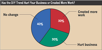

As its name implies, do-it-yourself (DIY) electrical work cuts out the middleman — in this case the electrician — and puts the tools in the homeowner's hands. And taken from a purely business perspective, that proposition ultimately begs the question, How much work are electrical contractors losing to the exploits of weekend handymen? As it turns out, not that much. In an informal poll conducted on EC&M's Web site, only 30% of respondents claimed to have lost business to do-it-yourselfers.
Of course, it's difficult to count the money you don't make, so those results may not paint the most accurate portrait of DIY's effects on the electrical construction business. If unqualified homeowners are routinely biting off more than they can chew with complicated electrical installations, it might be fair to assume that contractors are actually benefiting from fixing the problems created by those do-it-yourselfers. Fair, but not completely true. Another 30% of contractors surveyed said their businesses have received a bump from fixing DIY projects gone wrong, but “bump” may be an exaggeration. Of those who said the DIY trend has helped their business, 74% brought in less than $25,000 as a result of fix-up work and only 3% made more than $100,000 bailing do-it-yourselfers out of their homemade jams.

Despite the common argument that so-called “big-box retailers” like Home Depot and Lowe's are at fault for creating the demand for home wiring in a kit, the results of EC&M's poll show that an equal number of electricians think home improvement stores are simply responding to the demand. While 37% of the survey respondents place the blame for the DIY phenomenon on stores like Home Depot, 42% believe the homeowners themselves are responsible. No matter who's responsible for its popularity, DIY is big business. Since 2000, Home Depot has enjoyed revenue gains of more than 27%, bringing in $58.2 billion in 2002. And with state and local laws that continue to permit homeowners to work on their own homes, that chicken/egg argument could rage on for some time.
