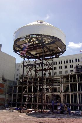

The electricians will soon be able to rewire and relight a piece of San Francisco's history — the Emporium dome, which features eight structural ribs and 800 pieces of glass. Prior to demolishing the existing six-level San Francisco Emporium building, the construction team preserved the dome by lifting it on top of a 120-foot temporary tower. San Francisco-based Swinerton Builders and Sheedy Drayage Co. developed a special rigging procedure in which a steel platform was secured to the bottom of the dome, bringing the structure's total combined weight to 680,000 pounds. Four strand jacks gently lifted the dome 60 feet higher than its original location. The construction team accomplished the engineering feat in two separate 30-foot lifts one week apart.
“It took a minute to go up one foot, and then we'd stop to make sure that everything was level,” says Barry Widen, senior project manager for Westfield, the general contractor. “We'd then kick in the jacks again and go up another foot. We lifted a lot of the ornamental sheet metal and plaster with the dome because the goal was to keep as many of the historical pieces intact as possible.”
The historical dome will serve as the centerpiece of the new retail, entertainment, and office complex. It's currently secured on a freestanding tower, but once the construction crew builds the new structural steel frame, it will be lowered 2 feet to its final resting place. At that point, the electricians will disassemble all the lighting fixtures, remove the existing wiring, and rewire the entire inside of the dome. Kuhn says the electricians will select a few sample locations, disassemble the fixtures, and assess the condition of the historic materials. If the surface isn't solid, then they'll meet with the design team and discuss how to proceed. Throughout the rewiring process, they'll adhere a piece of plastic film to the electrical boxes to avoid scratches and other damage to the historical building materials. After removing the wiring and light fixtures, the electricians will install new LED light fixtures, which have a rated 100,000-hour life.
