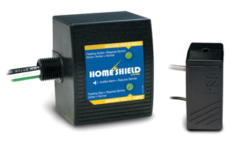

The result of that partnership is the HomeShield monitoring and protection system, which features a patented system monitoring and recognition technology (S.M.A.R.T.) design that monitors the earth ground resistance, presence of current, and presence of voltage on the electrical service ground conductor. The UL-Listed device's intelligent dual-stage hybrid arrester circuitry makes it possible to distinguish between “true” transient surge events and overvoltage conditions. By alerting homeowners to a potentially hazardous condition, it lets them take corrective action before a potentially catastrophic event occurs. “At first people think it's like a smoke detector for your electrical system,” Brumett explains. “But when a smoke detector goes off, you've already got a problem. When the alarm sounds and LED indicators [on the HomeShield] illuminate, the condition is still in its infancy and you have the ability to correct it.”
Scott McNeil, energy solutions representative and licensed master electrician at New Hampshire Electric Cooperative, a public utility co-op based in Plymouth, N.H., can attest to this claim firsthand. He has discovered and corrected several potentially hazardous conditions, including a shorted hot water tank, well pump, and air conditioner. He has not only installed at least 60 of the HomeShield devices for his employer since April, he also bought one for his own house.
Although installation is relatively simple, the process must be undertaken by a licensed electrician or utility representative because it involves work at the electric meter or the main service panel or disconnect. “The connections are basically made to the load lugs or the bottom jaws of the meter,” McNeil says. “There is a ground sensor that interfaces with the ground electrode conductor. “

Product SpecsService voltage 120/240VAC Clamping voltage 450V (6kV, 500A, 8 × 20µsec) Surge current 40,000A Joule rating 1000 (10 × 1,000 µsec) UL Listing OWHX, secondary arrester Ground resistance<25 ohms, 26-300 ohms, >300 ohmsGround Voltage <5V, >5V Ground Current <1A, >1A Housing NEMA 4X, weather-tight Dimensions 3.6 in. × 3.0 in. × 2.67 in. Unit weight 2.5 lb
