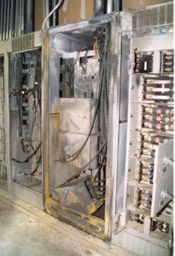

In April we switched up our usual format to give you an opportunity to review the details of an electrical accident and offer your opinion as to how to handle the situation. If you'll remember, an electrician was injured while installing a new feeder in a shopping mall's 480V distribution equipment main switchboard. We asked you to step into the shoes of the forensic engineer and the electrical contractor hired to perform the emergency repairs and tell us what you would do.

Get instructions in writing, including a “hold-harmless” agreement for “evidence spoilation.” Inform the owner of possible legal consequences of proceeding with the demolition of the damaged electrical equipment. Legal action against any party that alters or destroys evidence in these cases has become more prevalent.
Wait for the insurance investigator, or forensic engineer, to arrive before dismantling damaged equipment.
Document everything. Take photographs and video of the equipment.
Assume that there are other parties, besides the mall management and owners, that have an interest in determining what happened. These parties have the right to inspect the damaged equipment before it's altered or dismantled.
Develop an emergency power plan, such as the implementation of portable generators or alternate feeds, that bypass the damaged switchboard. It may be more expensive up front, but it will cost less than the legal costs of defending an “evidence spoilation” lawsuit later.
Assume that someone will be “second-guessing” your decisions and actions related to the repair methods that may affect the damaged equipment.

Immediately request that all emergency repair work stop. Review the contractor's action plan and plans for proceeding.
Schedule a conference call immediately with the mall manager, the mall's insurance adjuster, and the attorney representing the mall's insurance company to discuss your recommended course of action. You may not have authority to stop the contractor from removing the damaged switchboard, but you may convince others of the wisdom in doing so.
Like the electrical contractor, consider the rights of the other parties to the investigation, including the electrician's insurance company, the switchboard manufacturer, the electric utility, and the contractor that originally installed the switchboard. Also bear in mind that the city electrical inspector or an OSHA inspector may want to investigate.
Although your decisions regarding the repair of the damaged equipment will be subject to the review of the other parties, someone has to make the tough decisions, and the forensic engineer is typically in the best position to do so.
Ensure that when the decision is made to disassemble the damaged switchboard that the items are “tagged and bagged.” Each item needs to be photographed and identified as it's removed.

The accident introduced in Part I involved several of the issues noted by the respondents. The damaged electrical switchboard had been removed before everyone had a chance to see it. This often occurs because it isn't practical to delay repairs long enough to give all interested parties a chance to survey the scene.
The electrician contended that he wasn't at fault for the arc-fault incident. Instead, his lawyer argued, the arc flash was caused by pre-existing conditions of the equipment on which he was working.
As one respondent surmised, a problem with the protective device that should have prevented — or at least mitigated — the arc-flash event actually allowed the initial arc fault to propagate into the full-blown event that injured the electrician. As a result, the protective device manufacturer was also included in his lawsuit.
After the electrician and his lawyer filed suit, three forensic engineers investigated the incident on behalf of three parties. They wrote their reports and were deposed, and the matter was resolved with a confidential settlement.
The fact that the judgement and court documents were sealed is a matter for the courts. The lessons to be learned from this case — and from the readers who answered our call — are applicable in almost all cases of electric shock or electrocution. It's rare when only one party is called in to investigate the accident, so respecting the integrity of the scene is not only courteous but necessary to the investigation. Most importantly, conducting a thorough, responsible investigation takes precedence to getting things up and running.
