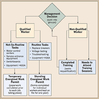

Routine and non-routine energized work permits. After reading 70E for the first time, you may get the impression that energized permits are required for each and every task. However, this is not the case.
According to the commentary in the 70E handbook, routine energized tasks can be grouped under one permit for a longer period of time. To handle these longer timeframes, a variation of the basic permit should be created. For instance, you might want to draft one to cover a one-year period. Companies can alter this timeframe to meet their needs. After one year has passed, management should review worker qualifications to make sure nothing has changed. This review can coincide with a worker's annual performance review, at which time new updated permits can be issued. Specific tasks should be written on the routine permit form so both electrical field workers and management clearly understand what “hot” work is permitted on a daily basis without further scrutiny.
What is considered routine may vary from company to company. One approach can be to consider routine work on panels 400A or less. Work below this threshold typically involves small 15A or 20A breakers of the plug-in type. Panels greater than 400A usually involve larger and more awkward breakers and higher incident energy levels where greater caution should be taken. In either case, a company should determine what it considers “routine.”
For all other energized work, a base permit (non-routine) should be used. This permit will cover non-routine electrical tasks and would be only good for as long as it takes to perform that task. Adding feeders into a large piece of gear, replacing 2000A fuses, and adding a bucket into a motor control center are examples of tasks that are not performed daily. A non-routine permit will need to be filled out each time such tasks are performed. This permit must also be signed and filled out by both management and electricians prior starting work.
Implementation of permit program. Once two permit forms have been created, some additional legwork is needed. Management should split electricians or company maintenance personnel into two separate groups: qualified and non-qualified.
There are certain employees in your company who make difficult jobs look easy, always making sound decisions in a clutch. You know, the ones you can leave alone to do almost anything. These are the well-qualified workers. There's another category for non-qualified personnel — the ones who have not quite finished the apprenticeship program or those that do not have the confidence from management in successfully completing “hot” work.
Every company has employees that fit into one of these two categories (see Flow Chart above). After employees are categorized in one of the two categories, employees should be informed of where they fit, allowing them to better understand their roles and capabilities. In addition, supervisors should explain to electricians the necessary steps required for someone to move from the non-qualified to qualified side of the house.
Once your field personnel have been divided into groups, a company meeting should be held to communicate your new approach. Workers should be educated on the difference between routine and non-routine type permits. Electricians should be instructed that “hot” work will only take place with written authorization. A company may have 50 journeyman and apprentice electricians but only 20 of them may be considered qualified. Typing up 20 annual energized permits and keeping them on file will provide documentation that the remaining 30 field workers are not allowed to work on equipment “hot.” The company handbook should be updated to reflect this new way of thinking.
