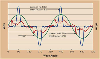

The proposed schematic design and second design option was to use harmonic mitigating transformers, which include both harmonic suppression technology and an electrostatically shielded transformer. Because they operate completely passively, they contain no electronic or switching elements, which means they use no power in operation and affect only those loads connected to them. They also limit the amount of current distortion (Fig. 1). The benefit of this option was that the triplen harmonics would be eliminated from the secondary power distribution system.

Final design solution. After running several price comparisons, it became apparent that using harmonics-mitigating 300kVA transformers with 1,200A busway would be more cost-effective than providing K-13, 300kVA transformers with 2,000A busway (Photos 1 and 2). As noted above, the harmonics-mitigating transformer removes the 3rd harmonic in the neutral, eliminating the need for oversized busway. We also decided to use “plug-in” style busway, which will provide greater flexibility for all future remodels (Photos 3,4, and 5).
Life cycle cost savings was another consideration for the use of the harmonics-mitigating transformers. While suppressing the harmonic current at the source, these transformers also provide for life cycle efficiencies. In addition to reducing the total harmonic distortion and neutral current, this technology increased the number of computer loads that could be carried per circuit, reduced I2R heat losses in the transformer and building wiring, and decreased air conditioning expense resulting from the need to remove I2R heat from the circulating 3rd harmonic in the delta windings of traditional transformers. The design also achieved real power cost savings due to reduced I2R heating that will apply for the life of the building.
