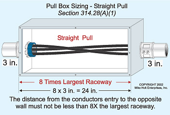

Straight-pulls [314.28(A)(1)]. A straight-pull calculation applies when conductors enter one side of a box and leave through the opposite wall of the box. The minimum distance from where the raceway enters to the opposite wall must not be less than eight times the trade size of the largest raceway (Fig. 1).
