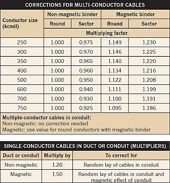

To make things easier for you, manufacturers provide reactance calculation nomographs that permit the determination of reactances per insulation thickness and conductor size for conductors at various spacings, a sample of which is shown in the Figure (click here to see Figure).
(A nomograph is a graphical calculating device and a two-dimensional diagram designed to allow the approximate graphical computation of a function. It typically has three scales: two scales represent known values and one is the scale where the result is read off. The known scales are placed on the outside (i.e., the result scale is in the center). Each known value of the calculation is marked on the outer scales, and a line is drawn between each mark. Where the line and the inside scale intersect is the result. These reactance values are derived from Equation 3. Based on the conductor and/or cable construction, you must apply the correction factors shown in the Table to any reactance values you obtain.

Problem 1. Suppose you have a 3-conductor, 500kcmil, 600V cable with galvanized interlocked armor on a 3-phase, 3-wire, 60Hz feeder circuit. Each conductor has 65 mils of insulation. What is the cable's phase-to-phase reactance?
Because you have 600V singles within the 3-conductor cable, each individual single conductor has no separation tapes, semicon tapes, shields, or other coverings. As such, you can refer to reactance tables and directly use the reactance value indicated in the “65 mil” column for 500kcmil, which is 0.0251 ohms per 1,000 feet to neutral.
Because the multiconductor cable's steel interlocked armor is similar to a magnetic binder, however, you have to multiply this value by the appropriate correction factor shown in the Table, which in this case is 1.122. So, XL is equal to 0.0251 times 1.122, or 0.0282 ohms per 1,000 feet to neutral.
The phase-to-phase reactance for this circuit is equal to 0.0282 times 1.732, or 0.0488 ohms per 1,000 feet.

Because the conductors are in a magnetic conduit, you must multiply this value by 1.50 (increase of 50%). Therefore, the inductive reactance-to-neutral at 6-Hz in ohms per 100 feet (XL) is equal to 0.0373 times 1.50, or 0.0560. The phase-to-phase reactance is 0.0560 times 1.732, or 0.097 ohms per 1,000 feet.
