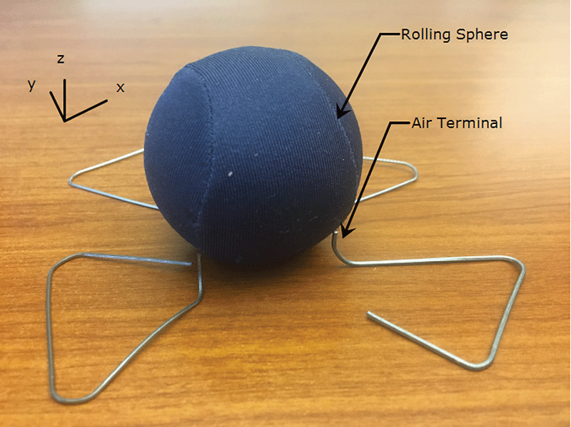

The concept of the rolling sphere is that as you roll an imaginary sphere with a radius of 150 ft, it must not touch a protected surface (Photo 1). Instead, the path of the sphere should touch a series of air terminals connected to cables meant to redirect the path of lightning safely to ground through a low resistivity path. In the example case of the 50-ft maximum spacing per NFPA 780, we can make a few observations. To satisfy the 150-ft rolling sphere, the lowest point on the z-axis of sphere must not break the plane of the roof level, assuming there are no “protected elements” above the roof.

The bottom quadrant of the sphere “resting” on four equi-distance air terminals of the same height would occur at the coordinates of the intersection of the midpoint of lines between Point 1-Point 3 and Point 2-Point 4 (Photo 2). The bottom quadrant point occurs at (25,25,0).
Given that the sphere radius (R) is 150, the center lies directly above the quadrant at (25, 25, 150).
Substituting the center, x-axis and y-axis values for any given point from the bottom of each air terminal location, we can solve for their required height “z” using the Cartesian equation of a sphere, which is 4.2 ft or 4 ft - 25/7 in.
