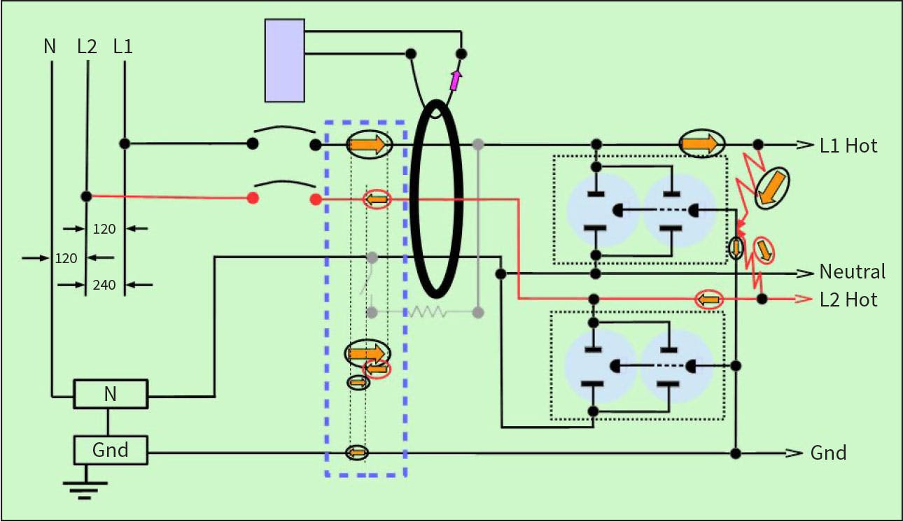

Now let’s consider the subject circuit: a 120V/240V multi-wire branch protected by a 2-pole (L1/L2/N) GFCI/GFPE breaker (Fig. 2). A second ungrounded conductor (red in Fig. 2) is added to the single-pole breaker current transformer as a third primary. This conductor originates on the opposite leg (line or split-phase) of the single-phase service source. It takes a switched path through the breaker and passes through the CT toroid to a load-side connector. From there, it is wired to a separate 120V circuit (L2), but it uses the same neutral as a return path. Normal load current flows out L1 hot or L2 hot to the load and returns on L2 hot or L1 hot, respectively, or on the neutral. The current on the neutral is the difference between the L1 and L2 currents [iN = | iL1 – iL2 |]. An L1 fault or leak to ground (red zigzag in Fig. 2) flows through the current summing transformer (on L1) without any offsetting current in L2 or N. Just as in the single-pole breaker, this imbalanced net flow in the primaries creates a magnetic field that generates a non-zero current in the current summing secondary, and the breaker trips at the designed trip current level.
Ground: where opposite faults meet
That explains the case of a fault/leak on one leg (L1) or the other (L2). But suppose there are fault/leaks on both the L1 and the L2 120V branch circuits. First, consider the case of equal fault/leaks (Fig. 3).
The current flow for equal fault/leaks is similar to that of equal loads (L1 and L2) — the return current for each uses the opposite leg. Follow the L1 fault/leak current (orange arrow in Fig. 3) from the L1 source through the CT out to the L1 leg fault. It flows to ground through the L1 fault path and then through the L2 fault to L2 and returns on L2 through the CT to the source. So no current returns on the ground or the neutral. The current that flows from L1 returns in L2 and vice versa. The current sum in the CT primaries is zero; therefore, there is no magnetic field, no current in the secondary, and no trip. Note that regardless of the size of the fault/leaks, if they are equal, the breaker will not trip.

But suppose one leak is smaller than the other (Fig. 4). Let’s say the 2-pole breaker is a GFPE with a 30mA trip limit. Suppose the appliances connected to L1 have a total fault/leak current of 25mA, and the L2 total is 15mA.
Normal currents (not fault/leaks) flow to and from the load on the L1/L2/N as usual; therefore they will flow in equal amounts in both directions through the CT and will not contribute to any current imbalance measured by the secondary. They are being ignored in this analysis.
Let's trace the fault/leak currents on the positive AC half-cycle (i.e., when the instantaneous L1 voltage is greater than the L2 voltage. See the orange arrows in Fig. 4). The L1 current, 25mA, travels from the source through the CT to the fault/leaks and then through them to ground. At the ground point, 15mA of the 25mA travels through the L2 fault/leakage path to the L2 circuit and returns through the CT to the source on the L2 circuit. The remaining 10mA follows the ground path back to the source via the panel ground to neutral bus connection. During the negative half-cycle, the currents all reverse on the same paths and in the same amounts. (The negative half-cycle is not shown in Fig. 4; they would be blue arrows equal in size and head to head with each orange arrow.)
The current imbalance in the CT primaries is: 25mA L1 source to load (+), 15mA L2 load to source (-) and 0mA through the neutral, 25mA + (-15 mA) + 0 = 10mA. The resulting magnetic field induces a current in the secondary indicative of a 10mA imbalance so the breaker will not trip (10mA < the trip level of 30mA).

One of the most troublesome and unhelpful consequences of 2-pole ground-fault protection of an MWBC is the effect on the push-to-test feature (Fig. 5). As described earlier, the test button produces a current imbalance just above the trip limit. Let’s suppose in the case of our 30mA trip example GFPE, the test circuit draws 31mA from L1 (shown in Fig. 5 by large orange arrows circled in black).
Provided there is no leak or fault on L2, the breaker will trip when the test button is pressed since the entire 31mA will be an imbalance. But if there is a leak or fault on L2 (shown in Fig. 5 by mid-sized orange arrows circled in red), a portion of the test current flows through the neutral-ground connection in the panel, through the L2 fault/leak and onto the load side of L2, and then back through the CT to the source, thus reducing the 31mA imbalance by the amount of the L2 leak. If the L2 leak is more than 1 or 2mA, the test button imbalance will not be enough to trip the breaker (31mA - 2mA < 30mA). Unless L2 is essentially free of fault/leaks, the push to test button will misidentify a good breaker as faulty.
Let’s return to our continuing example and actuate the test button. After reconnecting the faulting appliance, L1 has 25mA of fault/leak current and L2 has 50mA. If the test button is pushed, ~31mA is added to the 25mA L1 leakage path, bringing the L1 total fault/leak up to 56mA. With L2 fault/leak current at 50mA, there is a 6mA imbalance, 56mA + (- 50mA) + 0mA = 6mA, which is less than the trip limit. The breaker does not trip, thus indicating a bad breaker. A good breaker fails the push button test.
