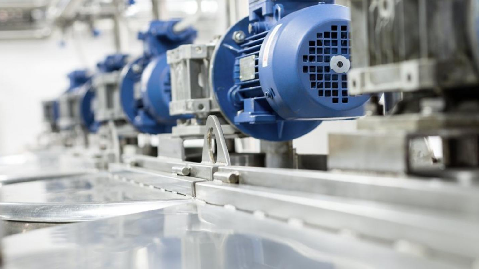

Danger #1 Shock hazard. If there is a difference of potential between the motor case and anything else around it, then a shock hazard exists. How do you eliminate this difference of potential? A common but incorrect answer is to ground the motor case. See the National Electrical Code Art. 100 definition of “ground”. The correct answer is to bond the motor case, base, disconnect, and other metallic objects to each other and/or to the equipment grounding (bonding) conductor.
Danger #2 Slipping hazard. When lubricating the motor, use a catch pan or similar. Wiping up grease after it hits the floor can still leave an oil film.
Danger #3 Tripping hazard. Is it necessary to step over the raceway containing the motor supply conductors just to service the motor? If so, then install new raceway around the obstructed area so there is a clear path for personnel and equipment.
Danger #4 Visual hazard. Ensure there is sufficient light for servicing the motor, even if that means installing a fixture just for that purpose.
