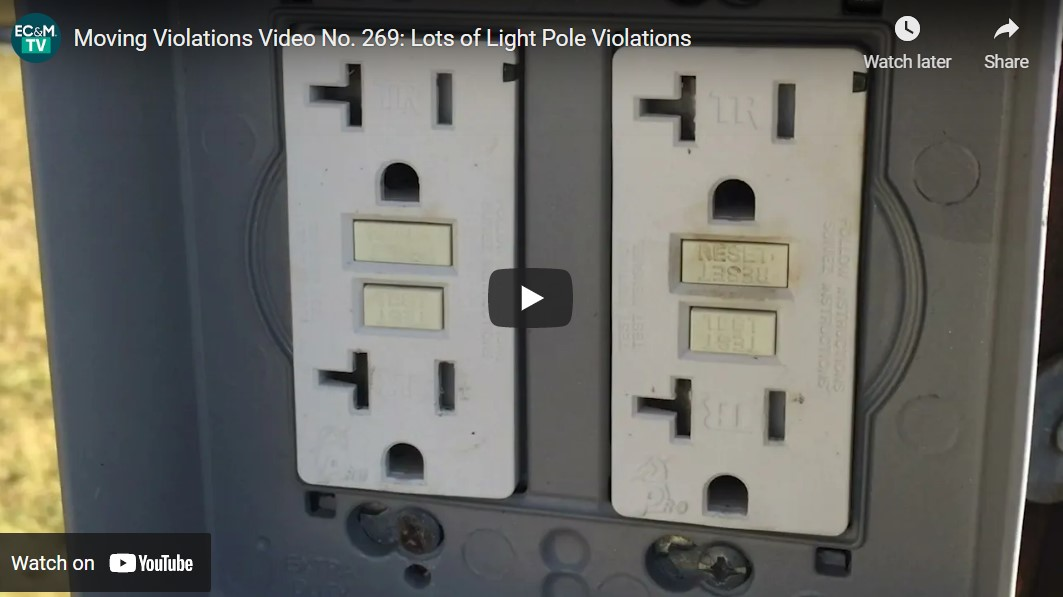

Russ points out several violations at a light pole location.
In this episode, Russ points out several violations at a light pole location. First, there’s a broken cover on the junction box and a missing cover on the receptacle outlet. The installer also used non-weather-resistant receptacles at this outdoor location. In addition, there are no expansion fittings on the PVC conduit run, which led to a mechanical failure near the top of the pole. This also resulted in exposed wiring. See Secs. 110.12(B), 300.12, and 406.9(B)(1) of the 2020 NEC.
