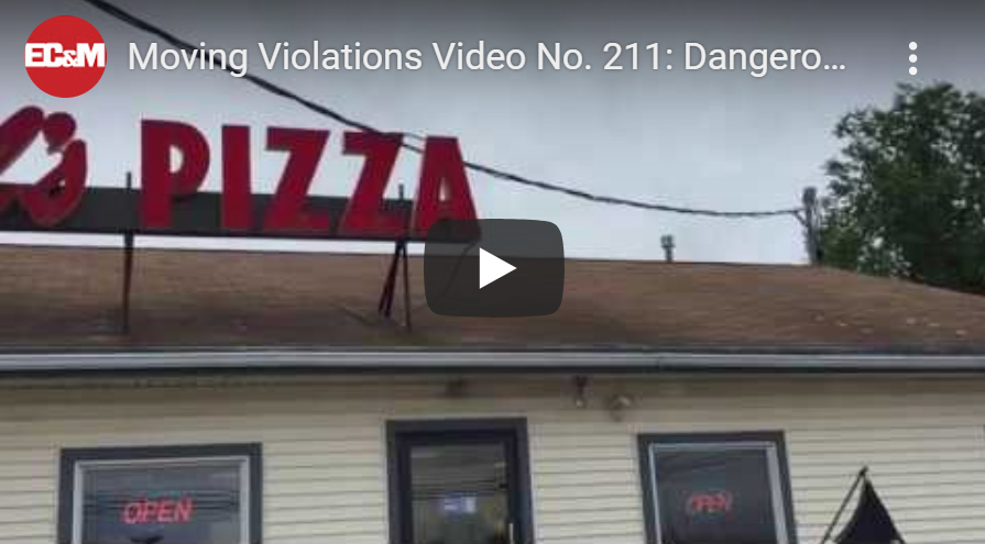

Russ stopped by this pizza place and discovered a dangerously low overhead service drop. The conductors were actually sitting on the letters of the sign. Any damage to the cable insulation could easily energize the sign and its supporting frame. NEC Sec. 230.24(A) requires an 8-ft minimum clearance above a roof.
