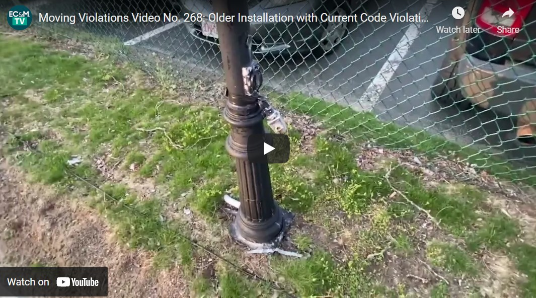

Russ shows us some violations at a light pole location.
Aug. 4, 2022
In this episode, Russ shows us some violations at a light pole location. The photocell unit is broken and dangling on the side of the pole by its wiring. The tape used to try and secure it to the pole is a violation of Sec. 110.12(B). In addition, the PVC conduit at the base of the pole also violates the cover requirements of Table 300.5.
