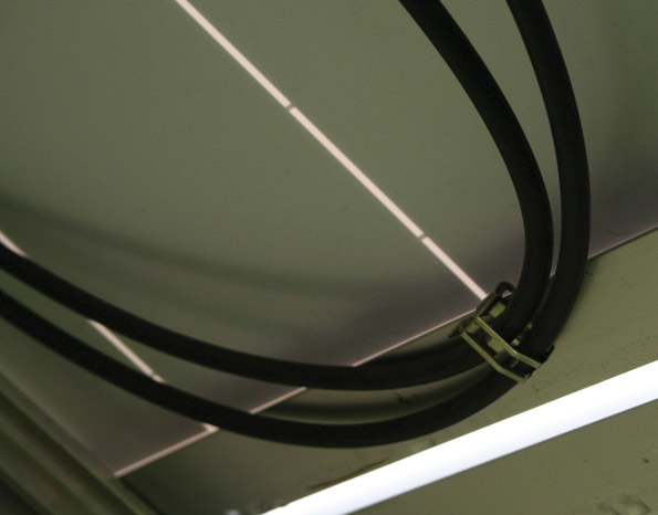

Photo 1. Conductors that are properly supported to the module frames are less likely to cause long-term problems. Various products are now available that are designed to clip to the module frame and hold PV conductors in place.
To help aide the installation community, a number of manufacturers offer different wire management products. One popular line promotes wire clips, typically made of stainless steel, which hold the conductors snug to the module frames (Photo 1). The S-shaped clips typically have a barbed slot that slides onto the module frame and bites into the frame for a secure connection. The other portion of the clip has a grooved slot to hold the conductor(s) in place. These clips are available for different wire types and gauges, so make sure you know what wire size you will be working with before ordering them.
