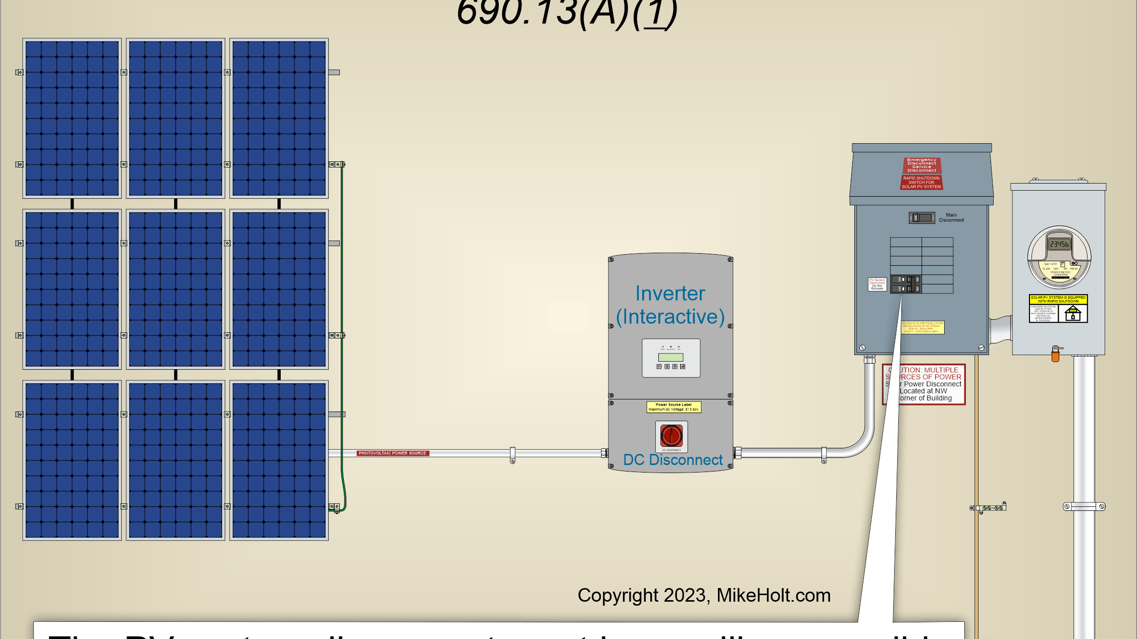

A readily accessible disconnecting means is required to disconnect power from each photovoltaic (PV) system [690.13(A)(1)], as shown in Fig. 1.
The door or hinged cover for the PV system disconnect must be locked or require a tool to open [Sec. 690.13(A)(2)]. The PV system disconnect must indicate if it is in the open (OFF) or closed (ON) position and must be marked “PV SYSTEM DISCONNECT” or equivalent [Sec. 690.13(B)].
Where the line and load terminals of the PV system disconnect may be energized when the disconnect is in the open (OFF) position, the disconnect must be marked with an electric shock warning [Sec. 690.13(B)]. The warning markings on the disconnect must be permanently affixed and have sufficient durability to withstand the environment involved [Sec. 110.21(B)].
